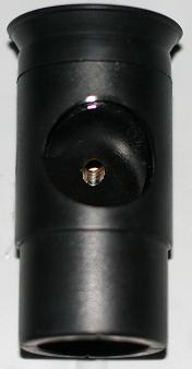

weixing, can you take a photo and let us see how that collimating eyepiece look like. I saw a rubber eyeguard at teh front which is not very commonweixing wrote:Hi,No... I think I shouldn't call it a cheshire eyepiece...Does this Cheshire comes with the cross hair?It is label as a collimating eyepiece.

Below is the picture of the collimation eyepiece.
Thanks and have a nice day.
PS: Hmm... seem like I should post as a new thread.
