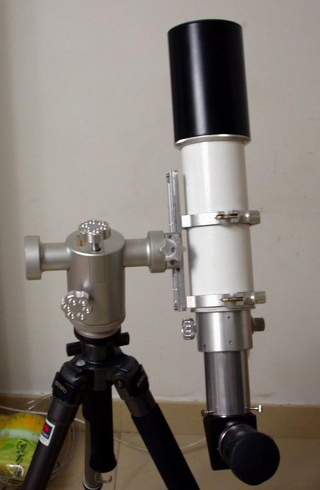

I will upload a picture tomorrow to show you the recently home-made feather touch focuser on a TMB80/480 apochromatic refractor.
