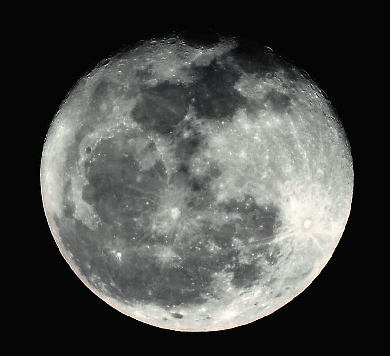

Hi Ray,
It is out of focus. Also, from the picture, the tripod head looks small compared to the refractor itself. It might be better to put it on something like the 410 equivalent or use a telescope tripod. I have successfully tried doing moon mosaics with the 410 on 190 tripod with a Borg 76ED refractor which is of a similar focal length to the Celestron. Definitely do a mirror lock up, and make as short exposures as you can (below 1/30seconds) to "freeze" the moon. Hat-trick might not be possible here as it does not yield deterministic exposure times, but more for deep sky exposures.

Hi Traveler : Oh, not using anything special. Just a normal Nikkor 24mm, 50, 135, 18-70 and the 80-200mm. Thanks for pointing out the typo....a 2000mm with F5 aperture will probably weigh in at 1 ton with a diameter of 3 feet :-D
Hi River & Aquillae : Didn't lock the focusing knob as I didn't felt a need to do so. Afterall, I removed all the unnecessary stuff like the flash and the battery pack leaving only the bare-bone D200 body. The D200 is the lightest body I have.
RCJ : I think you are probably right. The tripod may not be sturdy enough for the scope and my DSLR. As the D200 is the lightest body I have, no point attaching it to my D2X and F4E.
Therefore, will probably scout around for a studier tripod just in case I decide to upgrade to the C130 when my wife goes to US again.

Instead of upgrading to a C130 which is only about 60% increase in light gathering, I think you should go for a big dia like a C8 (4x more) or higher. And may don't even need to buy new, someone in this forum might sell theirs, so your poor wife don't need to carry the heavy monster all the way back plus you will like to pay less.

You better lock it... the focuser just need to move 0.2mm to give you a blur image for a F5 scope.Didn't lock the focusing knob as I didn't felt a need to do so. Afterall, I removed all the unnecessary stuff like the flash and the battery pack leaving only the bare-bone D200 body. The D200 is the lightest body I have.

Thanks for all the valuable feedback.....took some shots tonite of the full moon based on some of your recommendations and noticed that it is slightly better.
As I don't have a moon filter, I set the camera to B/W mode and underexposed it a few stops.
Although it is not as sharp as RCJ's photo of the moon, at least it is better than my first shot posted earlier on.
Noticed RCJ used an extender for his photo of the moon.....where can I get the extender ?
