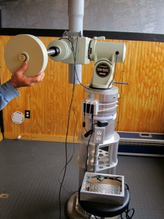

The seller has set the mount for latitude 1 degree. I have attached photos of that setting. Is a wedge still necessary when the mount can be set to 1 deg?

If the current owner says it can be used for latitude of 1 deg, then good. There is no need for a wedge
