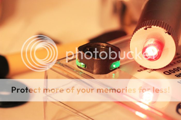

The vials are really tiny, just 5mm in length x 1.5mm diameter, really delicate to handle.

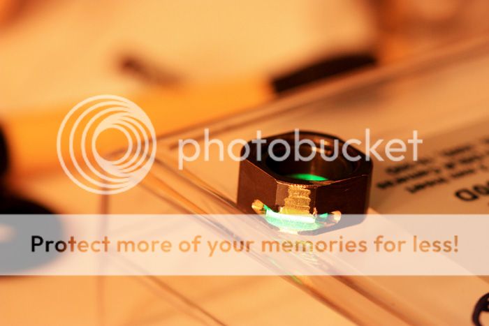

The Meade eyepiece has a centering optical block with etched reticles, this is where I inserted the luminous vials.
Requires 2 vials for sufficient illumination. As compare to original red LED illuminator, they are still quite a fair bit dimmer.

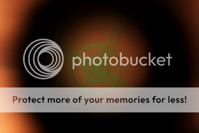

Success!! Took this directly through the ocular with my camera and macro lens, with 30s exposure in a dimmed room.

Hi alweek, yes I cut the slots with Dremel cutting tool, and the vials are properly secured with clear epoxy.alweek wrote:Genius! Did the eyepiece have slots in the side for the tritium tubes or did you cut them?

Nice DIY job. Had you try in a real dark environment? Just wonder will the light leak into the FoV? Anyway, I think a red one might better... ha ha ha

Re: Tritium Illuminated Reticle Eyepiece
Hi Weixing, yet to try it on an actual dark site, but I think it will work. There is some light leak, but the illumination is so feeble that it hardly affect the contrast of the viewing. Agree that red light would be more ideal, but their output is very dim, only about 20% as bright as the green. As you can see from the pic, I actually needed 2 green vials to provide sufficient illumination.
