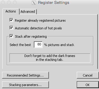

I noticed there is a message "Don't forget to add the dark frames in the stacking tab" under the Register Settings. See attached file.
May I know what that means? As mentioned, I have already checked all my Light, Dark and Bias frames. Don't understand why there is this message?

Regarding Register Settings, it seems that your Dark files may not be registering.
I tried a simple 3-frame stack of Lights, Darks and Bias files (like yours).
When I click "Register checked pictures", I get this:
When I added the Flat files, I get this:
As Steve's guide said - Green is good.
You can also refer to the frame list to see if all your selected frames are registering correctly:
Once stacked, the RGB/K should show this:
Move the centre arrows so that you align the Red, White and Blues and position them so that it sits just to the left of the starting curve.
In Luminance, I keep the Darkness and Highlights at "0" and keep Midtone at "10", then adjust the 2nd bar slightly:
Lastly, Saturation I move it slightly to about 14, or thereabouts:
Final image saved to TIF looks like this, ready for photo-editing software:
Hope the above helps!

Thanks for the very detailed step by step guide. I think I have tried everything there is... the only suspicion i have now is that I'm running DSS on a Mac platform. Have done a bit of searching in the internet and there are some that says they can't seem to get DSS to work on a Mac :(
Thanks for your advise. Will have to try running DSS on a Windows environment and see what results I get.

Ah ok.
I was wondering about that. Noticed your Register pic seemed to be from a Mac but didn't think that could be the problem.
