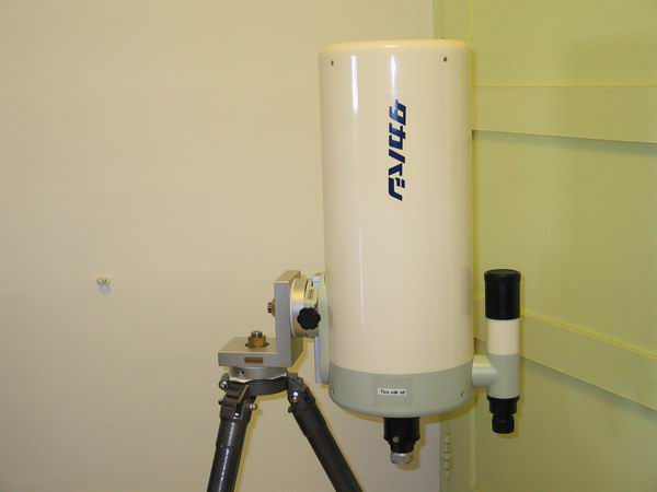

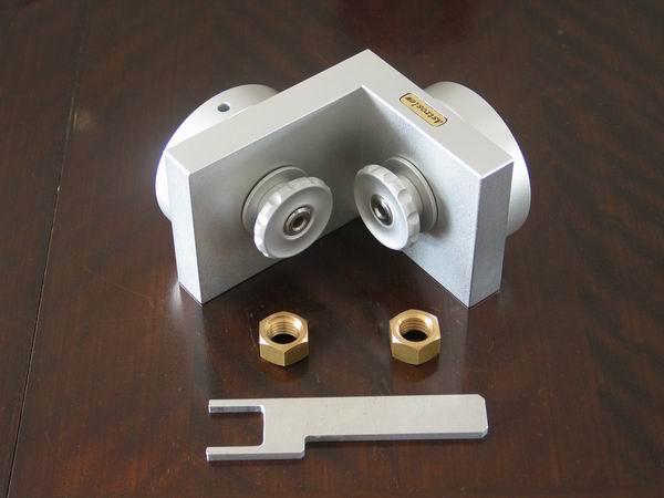

Only four pieces of Astroslew-II were made and this is the last one. Its frame (L shape) is cut from a solid block of T 7050 aluminium alloy (more strength than T 6061), there is no welding, casting or bolt connection at all. Both its altitude and azimuth have 4-inch Teflon padded friction surface that provides stable and smooth glide for your scopes up to 10 to 12 kg. It also uses stainless steel shaft and self-centering tapered roller bearing to make sure that the altitude and azimuth axis remain orthogonal as much as possible.
Other specifications.
Bottom hole size: 3/8 inch threaded
Mounting surface: two M8 holes with 35 mm separation
Dampening time: 0.4 second (tested with Mewlon 210 at 200 X, using Gitzo MK-II 1500 tripod and vibration pad)
The package also includes two brass nuts and one spanner shown in the attached photo.

example to setup Mewlon 210 OTA
astroslew setup.JPG (15.9 KiB) Viewed 1648 times
The astroslew-II mount package
astroslew mount.JPG (25.65 KiB) Viewed 1648 times

wah, sell so fast? those who wans it better grab it fast. i have tried it out on liu ming's 4.5" apo. very nice to track even at 268x. i could feel no vibration when focusing. slewing ard at abt 25x, u could feel that there's almost no feeling of any mount. if i have a 4-5" apo, i would have already grab this last piece straight.
~MooEy~
Posts: 2405
Post by rlow »
Yes, I have personally tried this and it is indeed a very solid and smooth altazimuth mount. And I would believe it is heavyduty enough to handle even a 8"-11" SCT ota.
