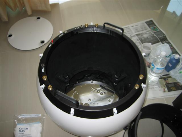

Anyway, the Portaball mirror was getting so dirty that its performance was noticeably degraded during last sat's Mersing trip, so its time that it take a bath. Made a trip to a pharmacy and cold storage to get some isopropyl (spelling?) + cotton-wool and distilled water respectively.
Quite an easy task cleaning the mirror... its a one-hour job.
-puff off dust with a blower
-pour tap water onto the mirror with it in-situ in the ball (the water drains off from the ventilation holes near the bottom of the ball)
-pour a diluted alcohol solution followed with some gentle rubbing with the cotton balls
-rinse with distilled water
-tilt the portaball to let all the water roll off
-repeat previous three steps till the entire mirror is clean
-puff it dry with a blower
And done! Clean and shiny again! :) I need to do this more often!

I tried cleaning my dob in the evening too. I did not use cotton wool and found out that the dust still stays even after flowing with tap water for a long time and finishing with distilled water. I will buy the cotton wool and try again. I guess it is necessary to wipe the mirror gently with the cotton wool.... thoughts of just using water and not touching the surface of the mirror does not work. Thanks for the pictures.

Hi Yang Beng, yes you really need those cotton balls to get rid of dust that may have been 'bonded' onto the mirror by repeated nights of dew. When I first tried this method I was freaked out about scratching the mirror but after have cleaned my portaball 8, orion xt 10 and now portaball 12 this way, I found that the coatings are pretty tough. Apply only very light pressure (just the weight of the water-soaked cottonball will do) and you should be fine. Work in a brightly lit area so that in case a grit causes a scratch (touch wood, have not happened yet...), you will notice it immediately. Replace the cottonballs often.

Lucky that there are ventilated holes now. In the past I had to put towels at the side so that it soak up the drained water.

I am considering sealing up most of the ventilation holes, as they create a dust nusiance for the mirror...

What's the purpose of distilled water being the last step? Thanks.
Distilled water won't leave behind any stains.
Anyway, don't attempt to surface clean large optics when humidity is above 65%. Streaking will result if you clean your optics when the humidity is high.
