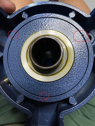

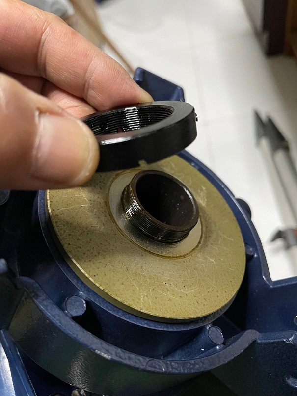

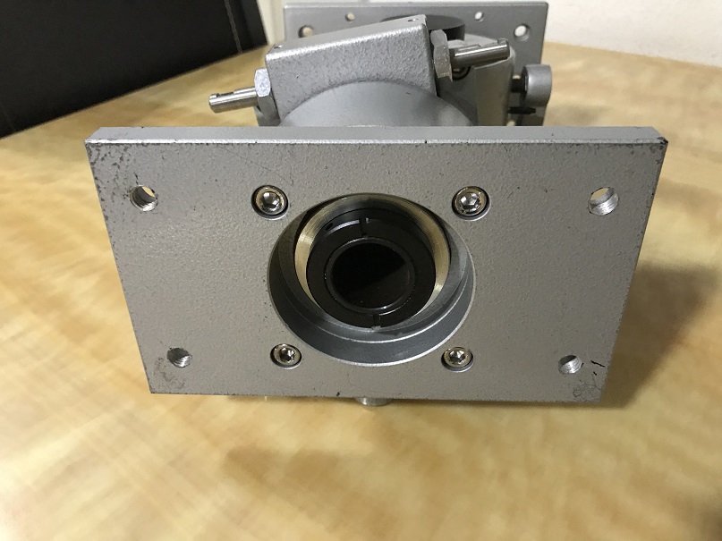

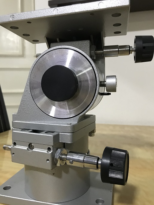

Re: Modifying a calton altz mount to become one of the best everHi
Probably due to dried stubborn grease? My mount locking ring can be removed but found that there are 3 small pins attached from tripod hub to mount, I think it needs to be removed to detach. But I am still not sure mount can be detached from tripod hub after remove these 3 pins.
There are 2 type of Carton TA mount, blue one with tripod hub and metallic color without hub, slight different at the base.
