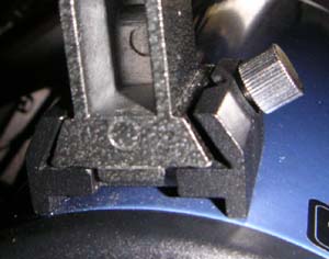

The bottom of my red dot finder is not a flat surface, but an arch shaped bottom to fit into the skywatcher series finderscope base. Plus, the finderscope base is elevated, so when i tried (a futile attempt) to use the thick kind of double sided tape to put the red dot on the scope, the up/down adjustment of my red dot couldn't even reach the target.. I need to find a way to tape the red dot finder onto my scope, or else i'll have to keep changing finders just to find a hard to find object.. very leceh and sometimes i'll also accidentally hit my finderscope which means i need to REALIGN it again!!

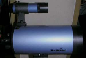

How my scope looks like with only the finderscope on

The base of the finderscope. It is elevated, so my red dot can't reach the target if mounted on the scope's surface.

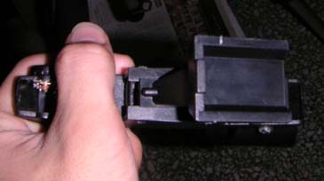

The base of the red dot finder. The base is not flat, and even has a protrusion at the end of the base (left of base) so i can't mount it nicely on the surface.

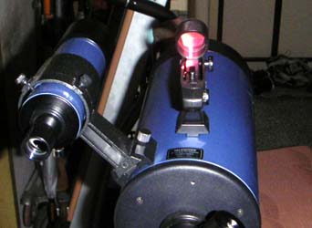

How i'd like it to look like finally. The red dot is now attached only by thick double sided tape, and hangs precariously..

You may replace the stand with Stellarvue's Extra Curved Dovetail Base for Red Dot Finder #F1001B (US$6).

Maybe you can try this for the RDF: use double-sided tape to stick another quick-release base, which you can probably buy from Robin or Joo Beng. Better still if you can glue to the underside of the quick-release base a piece of wood which is curved to the radius of the ota.

One solution I have thought of is to just stick the finder at the bottom edge of the OTA so that the protrusion sticks out using the detachable 3M sticker.
Alternatively, you can file down the protrusion and stick it where you intend.
