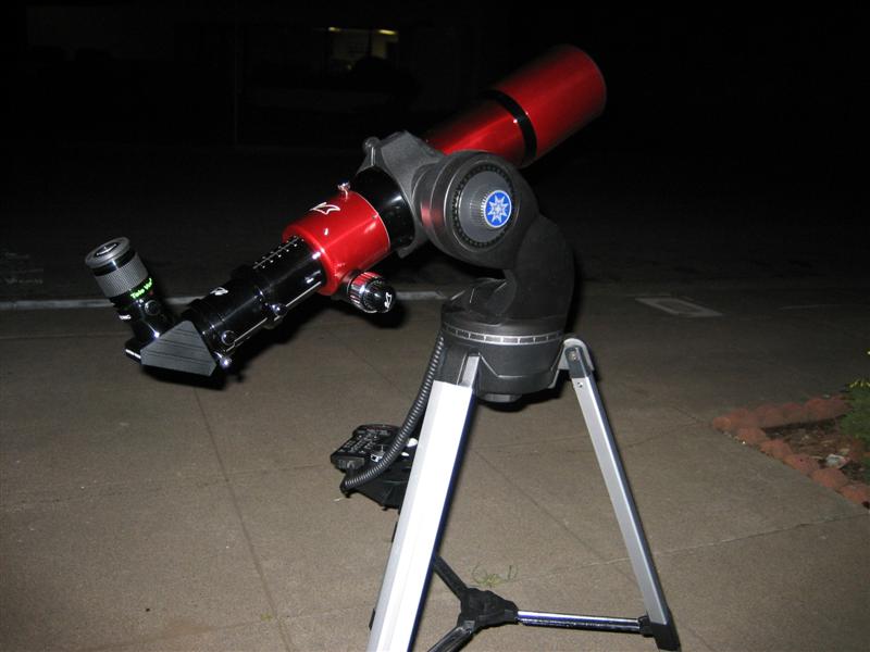

Here's a pic with the WO OTA. The WO is heavier but shorter than the Meade, and the mount handles it quite well. Barely perceptible vibrations when focusing at 40x and ok (<2 second dampening time) at 120x. The alt axis has a surprisingly large torque, but I will still be careful to balance the OTA correctly and not mix the use of ultra-light and ultra-heavy eps.

I didn't know that it is still available. Would I be able to get one? I'm thinking of mounting the etx90 on it, but would it track well enough for some webcam work?
btw, you WO combi looks really good. Can it reach the zenith?

The ETX90 OTA is short and light so the mount will work very well. Only issue is that the OTA will be too large for the stock bracket so you will have to fabricate a new one.
Not sure how critical tracking is for webcam work but for your reference, Saturn essentially appears stationary for over 5-10 minutes at 120x. The tracking seems to be much better than my ex-Nexstar5.
For the WO OTA, collisions with the tripod may occur at zenith but the autostar will issue a warning beforehand. The ETX OTA is too short to cause a problem.
