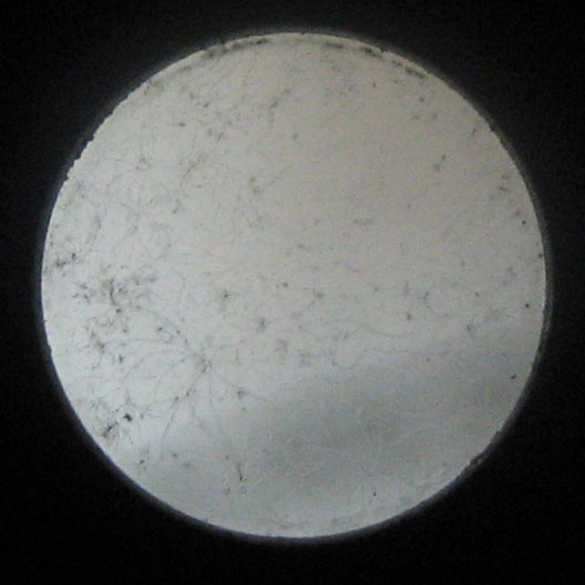

Post by tphilip »
Attached is a picture of a moldy lens. Looks nastier in the picture than by eye and its the worst of the bunch. Maybe beyond salvage - depends if the alkalines secreted by the mold have etched the glass or damaged the coatings.
