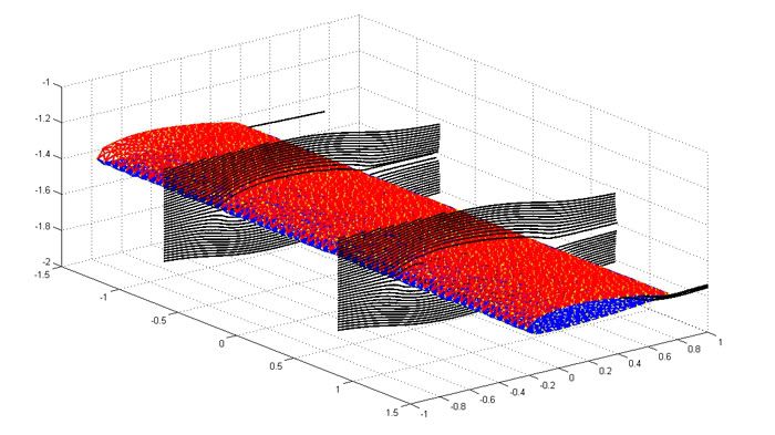

Finally got started on this. i think i have figured out the fluid part.
This is a simulation of a cubic fluid domain subjected to different temperatures at the top and bottom. The navier-stokes and temperature diffusion-advection equations are solved.
The loops are stream traces showing convection rolls. Now we have to figure out how to get an array of such rolls, and how to incorporate maxwell's equations.
