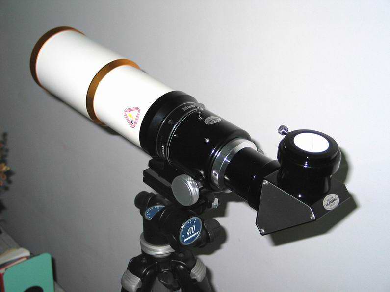

Equipment Brand: William Optics
Equipment Model: Megrez 80 II ED triplet apochromatic refractor telescope (sold)
Clear aperture: 80mm
Focal length: 560mm (F/7.0)
Objective lens: air spaced triplet, center element made by Schott FK01 ED glass
Focuser: 2” crayford style with 1.25” adapter
Real Name: Liu Ming
Contact Number: 67904202 (weekdays)
Email Address: biuliuming@yahoo.com
Condition of Item (as per guidelines): 10
Package include: (info in bracket indicates condition)
Item 1: OTA (optical tube assembly, lens (mint), tube (9/10)) + 2” mirror diagonal (97% reflection, 10/10) + 25mm Plossl eyepiece (10/10) + 6 X 30 finderscope bracket (mint) + backpack style carrying case (9/10)(all are original William Optics made except for eyepiece)
Additional Comments:
Important Note: The scope is an update from WilliamOptics’ Megrez 80II, not Megrez 80 fluorite version. I got the ED triplet lens from W/O factory in this Aug. and installed it on megrez 80 II tube.
Performance: 160 X magnification is easy (50 X per inch of aperture), cleanly split double/double in Lyra in Singapore sky.
Links:
http://www.excelsis.com/1.0/entry.php?s ... ntryid=573
http://www.buytelescopes.com/product_list.asp?m=49&d=1 (see item 1)
http://www.astronomy.com.cn/bbs/viewtop ... highlight=
http://www.astronomy.com.cn/bbs/viewtopic.php?t=26879
WTS:William Optics Megrez 80 II ED triplet apo (SOLD)

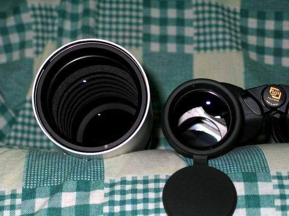

- lens coating compared to deluxe Fujinon EBC coating

My review on W/O yahoo group:
“Kept my old Megrez 80II tube and bought the new ED triplet lens
(F/7) from WO, a two inch extender tube is needed to provide enough
back focus. The service of WO is quite good and speedy.
1. the lens coating is much better than my old megrez 80 II, the
reflection is same as that of Fujinon's EBC(electron bombardment
coating) coated lens. Not sure if the coating quality is consistent,
I hope it does not vary from batch to batch.
2.color correction: much better than megrez 80 II, can be easily
pushed to 160 X (2 D) with trace green halo discernable. Even at 336
X, the image of high contrast object didn't break down.
3. Vega shows a little bit halo at 140 X, double-double at lyra is
cleanly split at this power, which is no easy for my old megrez 80
II.”
