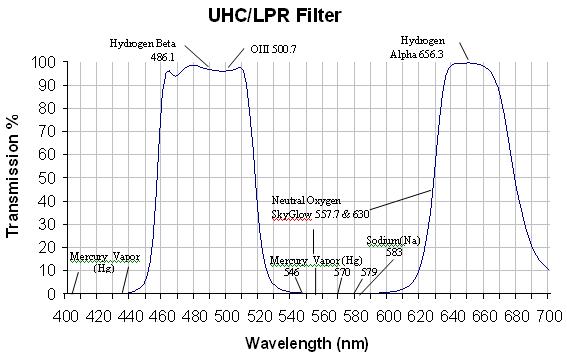

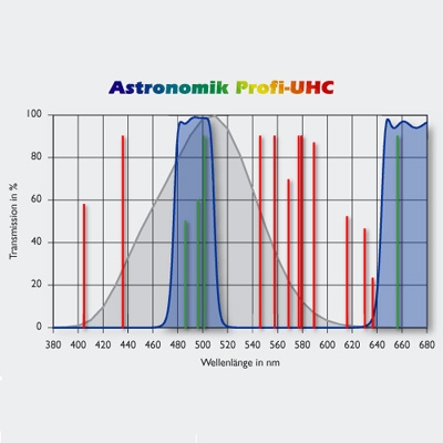

The Spectral Respond Charactersitics graph seems awfully similar to Ultrablock and Astronomik Professional UHC filter peaking at Hydrogen Alpha and Beta and cutting off the rest of the lights. Thus I am wondering what's the difference.

Start of 1st Bandpass
Celestron UHC/LPR:
The respond curve start at 440nm and start to peak at around 465nm.

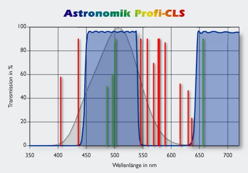

Astronomik CLS:
The respond curve start at around 435nm and start to peak at around 455nm.
Astronomik UHC:
The respond curve start at around 465nm and start to peak at around 480nm.

Celestron UHC/LPR:
The respond curve start to decline at 510nm and end at around 540nm.
Astronomik CLS:
The respond curve start to decline at 540nm and end at around 550nm.
Astronomik UHC:
The respond curve start to decline at 505nm and end at around 520nm.
Widest Bandwidth of 1st Bandpass
Celestron UHC/LPR: around 100nm
Astronomik CLS: around 115nm
Astronomik UHC: around 55nm
Start of 2nd Bandpass
Celestron UHC/LPR:
The respond curve start at 600nm and start to peak at around 640nm.
Astronomik CLS:
The respond curve start at around 630nm and start to peak at around 645nm.
Astronomik UHC:
The respond curve start at around 630nm and start to peak at around 650nm.
Astronomik CLS is the Astronomik version of broadband filter.
Anyway, base on the graph, I would said that the Celestron UHC/LPR is an improve broadband filter... somewhere between a broadband and a narrowband.
Celestron UHC/LPR Curve

Here is the curve of the Astronomik CLS (Broadband) and Astronomik UHC filter.
Astronomik UHC Curve
Astronomik CLS (Broadband) Curve
