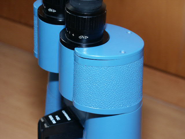

i have tried to locate the prism screws but am unable to because it is not on the surface of the binoculars as mentioned in the review
i guess it would be better for me to approach the expert. does anyone do any form of repair over here or know any dealers doing clean up and servicing for the binoculars?

hi there Kayheem, the whole binoculars is made of brass and metal. there is no way for me to see the screws because there are no screws in the first place. just plain metal.
thank you.

Please upload a pic, showing where the screws should be, according to the links I gave.

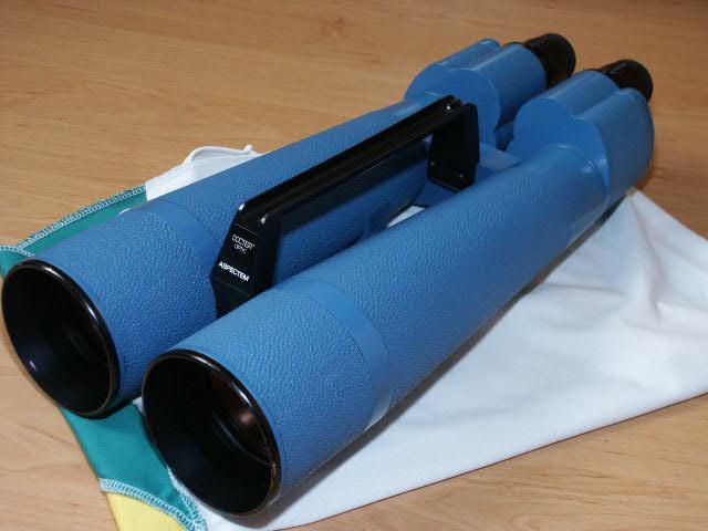

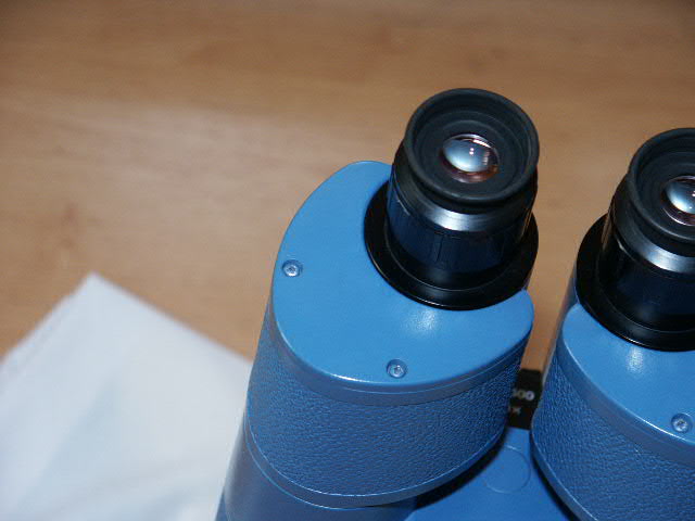

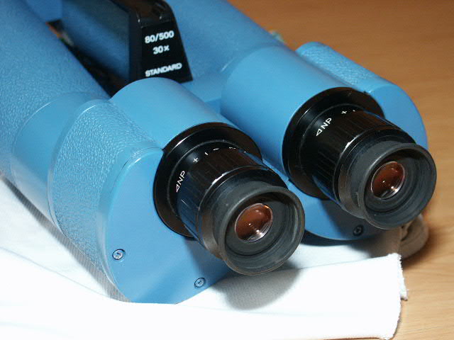

kayheem wrote:Please upload a pic, showing where the screws should be, according to the links I gave.
here are the photos. my binoculr is fully brass and metal there is no rubberised coverings as seen in the pictures.

I do not know where you bought it, how much it costs or if there is still warranty. If the is still warranty, you should send it back. If the warranty is out, you can try to remove the screws holding the plate under each eyepiece to see if the collimation screws are there.
However, if these cost a bomb, I would try to search harder for a professional collimation.
