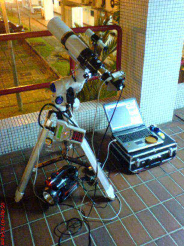

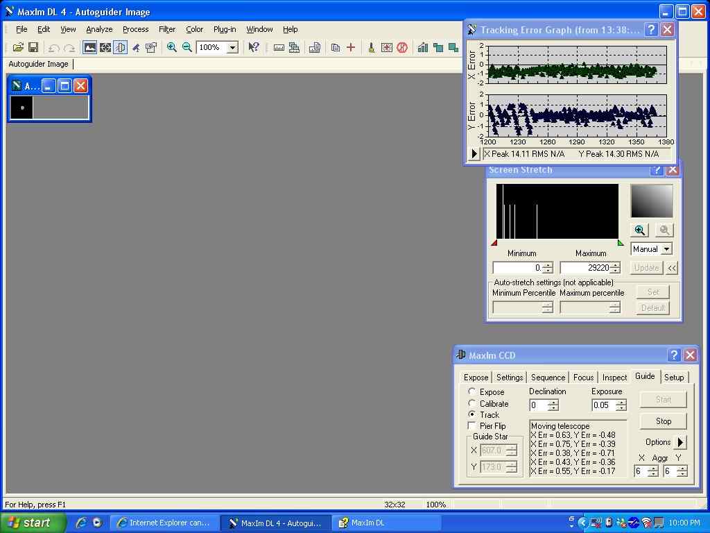

Trifid Nugget with SS2K report
Hi all, the night is good and so there is a chance to test the trifid Nugget with SS2K mount (rewired to ST4 pinout)
Equipment used:
William Optics Megrez 80mm II with Apograde at 555mm focal length
SkySensor with Autoguider on with 0.9 rate for RA and DEC
MaxIm DL with Agressiveness X=6 Y=6
Nugget with typical exposure 0.01s and 1 dark frame subtraction
Dimmest star seen is the 4th star of the trapezium in M42
Tried guiding on Betelgeuse = excellent guiding
Tried guiding on one of the belt stars of Orion = excellent guiding for at least 15 mins
Any star dimmer than that was guided unsucessfully.
Here are the pictures:
Equipment used:

- Attachments
- DSC00548_77.jpg (63.7 KiB) Viewed 30828 times
- Clipboard03_35.jpg (63.21 KiB) Viewed 30828 times
