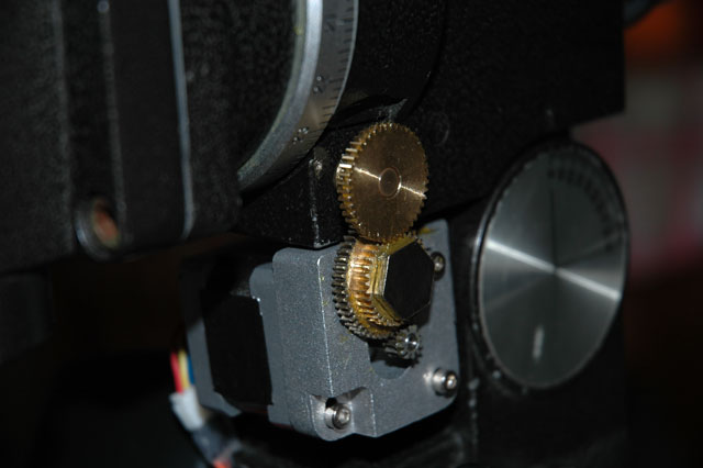

Installation wasn't that hard. You take out your older mt-1 motors, put the new steppers in, try to get a gd mesh and then tighten the screws. The screws are M5. The original screws on the vixen mt-1 are m6, so they dun fit each other. For the older SP mount, in the ra axis, u need a 6cm or maybe slightly longer screw. The screw provided is 4cm, which is meant for the SVP/GP series.

Went back home, luckily could find meng lee online, we went thru most of the settings and still found nothing wrong. Suspected could be either gearing ratio diff, or controller fault. I check with the setting circle the next day indoor and found no prob with the gearing ratios. Isolated problem down to controller.
I did the firmware update. Went up to 3.21. Another dry run indoor shows much better pointing. Could it be a corrupted firmware right from the start? Original firmware was 3.12, shouldn't have much prob.
Went out last night to try under the stars. Did a 2 star alignment. Everything works perfectly now. The goto would center onto most objects, but that's with a pretty wide tfov.

A pic of the completed mount. Some side comments, it fits on the SP mount, but you need to get the 6cm screws. The motor cover for RA would not fit the older SP mount, might be a perfect fit on the GP mount. Then again, would need to check that out. Gear ratio is the same between SP/GP/SVP so u should have no issue with it. On my SP mount, the RA motor is slightly tilted for a gd meshing.
