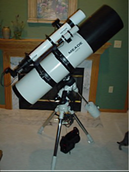

The refractor in the last pic is so impressive. What brand is it? For consideration, you will need bigger dry cabinet to keep refractor. I still saving $$ to buy 160L cabinet to keep my scope. Bcos they sell COD only.
Saved me lots of money (spent no more than $40 max), plop in a Meade DSI and fire up PHD. Besides you don't need super sharp stars to guide. As long as you have a fuzzy one and it moves well enough for PHD to calculate...you get 'green' crosshairs everytime! And after my last Hack to my DIY guidescope, 2" extension tube collars fit very well into 50mm PVC pipes. This makes connecting adaptors, focusers, etc very easilly! Plus the whole thing adds the right amount of weight fore of the scope to balance out the DSLR on the bottom end.
